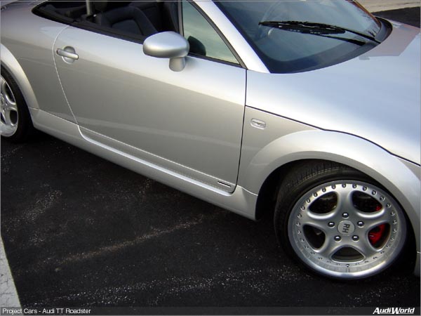

Based on the parts we had selected the last part of the installation was the side door panels. The panels are definitely the easiest to install, as they do not require the removal of any existing pieces or new drilling. Prior to installation, however, we did thoroughly clean the body panel with prewax cleaner in order to give the heavy-duty double-sided tape a good surface with which to stick. Leaving wax the paint prior to installation will eventually cause the doubled-sided tape to absorb the wax and lose its stickiness. Installation is as simple as lining up the side sill panels with the factory lines of the factory door seams and pressing them onto the surface.
What makes the appearance of this kit so impressive is that it meets our original goals well. That is to say it that it integrates well with the designer's original lines and adds just the right amount of flare to the car. The kit also personalizes the car, making it distinctive from the average stock TT on the road.
