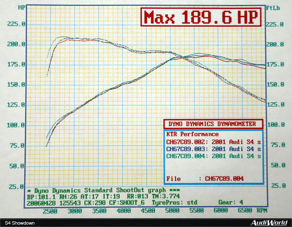

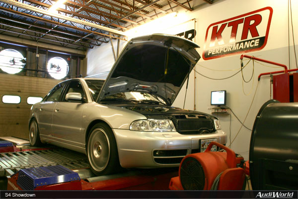

KTR uses a Dyno Dynamics chassis dynamometer. Compared to many other types of chassis dynamometers, these are said to read ‘low’. So, the numbers we see here will not look at all like the ones on the other dynamometers. What we did to show the general baseline was bring along Rob (‘Bahn Burner) and his stock 2001.5 S4 6 speed.
While I was busy pacing like an expectant father waiting for Erik and Jason to arrive at KTR with their friends Mark and Mark, who run East Coast European, up in Greenland NH (They were hustling to get Jason’s new APR RS4 intercoolers on his car that very morning), Franz Diebold, General Manager and tuning wizard (not to mention, really cool guy!) strapped Rob’s silver S4 onto the dyno, and started calibrating it for the car. Franz explained that the Dyno Dynamics machine is an inertial style dynamometer, so it needs to know a bit about the car that’s running on it. Also, Franz did give us an estimated crankshaft power figure, but I’m sticking with the power at the wheels, because that way there is no interpretation required.
Stock 2001.5 S4 6 speed, stock ECU:
burner_dyno stock_small

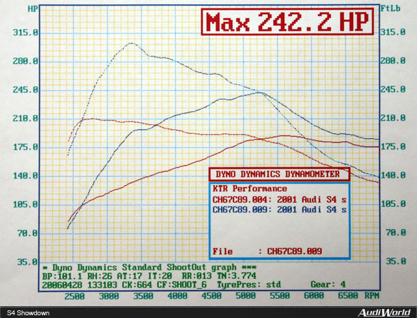

This is stock, at the wheels. Since we were still waiting for Erik and Jason, Franz put Rob’s APR chipped ECU into the car, and did some more pulls. The results were pleasing to me, because, even though the car seemed to be making very low power (Franz said what we saw was actually quite good for a stock S4), the increase from stock to the chip was exactly what we’d expect it to be. Again, that was at the wheels.
apr_chip_k03

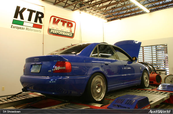

2000.5 S4 6 speed, APR Stage 3 RS4 Kit (running on 112 octane race gas, on the APR race gas profile):
Here is Jason’s car, strapped to the dyno, screaming it’s lungs out.
jp_dyno

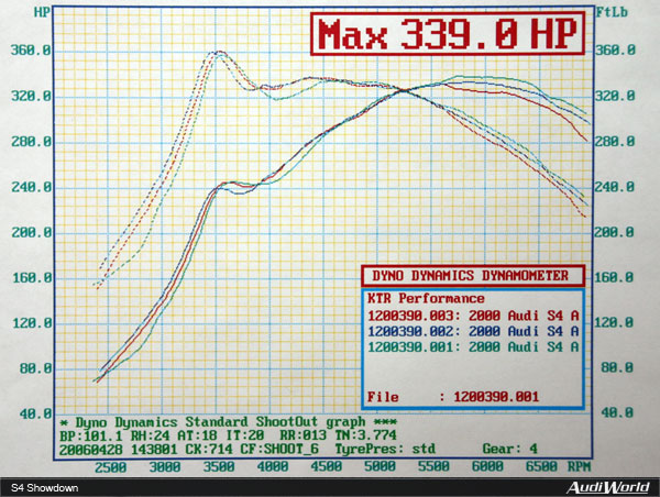

Jason and Erik were both running the same 112 octane racing gas, as they both wanted to see what the cars would do on that rating of fuel. We ran Jason’s car in the race profile, and in the pump profile, which showed a significant difference, even though it was still running the 112 fuel. The below dyno chart is on the race profile, at the wheels.
apr_rs4_race_small

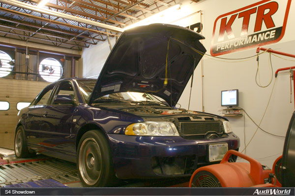

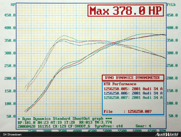

2001.5 S4 6 speed, AWE Stage 3 RS4 Kit (running on 112 octane race gas, on the AWEpump gas profile):
Last but not least, Erik’s car was strapped to the dyno. The car was set in pump gas mode for the first pulls, even though it had 112 in the tank. This car made a wholly different sound than Jason’s and Rob’s cars. It was much throatier, we all noticed that right away.
es_dyno
Strangely, Erik’s car made more power on the pump profile than on the race profile. Franz saw that the car made more boost in the pump profile (he had hooked into the vac lines so the dyno would see manifold pressure)
awe_rs4_pump_small
In the end, we were left wondering why the APR car made so much less than we thought it should. Was it a bad O2 sensor? The exhaust gas analyzer read that the car was running very lean. That may have had something to do with the lack of power. It didn’t seem to be pulling timing, and it was running basically the same boost levels as the AWE car. Perhaps we’ll never know. Maybe one day we’ll have a chance for a rematch.
